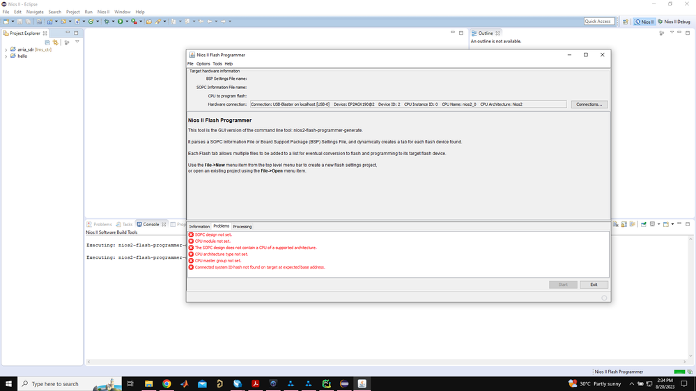

      I used hello world example i changed quartus window to Linux even i changed board but expected sysid base address not found all our cases i am using quartus 18.1

  • Hi,
    What is the Quartus version used? Also, could you share the screenshot of the mismatch seen?
