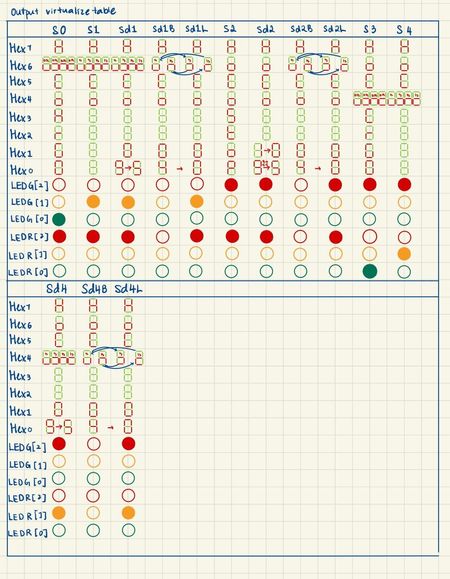

1 year agoMy verilog code work in stimulation but not working in hardware
This is my assignment that required to design a traffic light with delays, display countdown with 7 segment display. My verilog code is working in stimulus using Modelsim but not working in Hardware(...
