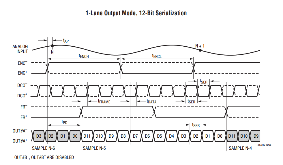

I am trying to connect 8 4-channel ADC to an Arria 10 FPGA. The ADC (LTC2171-12) has 4 differential LVDS pairs as well as one LVDS pair for the frame clock and one pair for the data clock.
The target is to reach a data rate of 360 Mbps. The image above shows, that the data output is in double data rate.

The ADC has bit depth of 12, which can be seen in the image above. To achieve this I wanted to set the "SERDES factor" to 12, but 10 is the maximum. My next guess was to set it to 6 and then later put it together in FPGA logic.
Is that the correct way to achieve a SERDES factor of 12?
