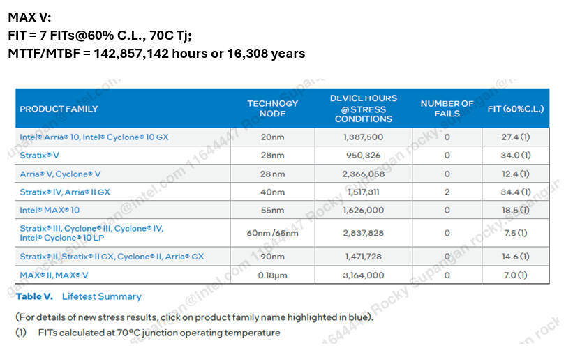

I need MTBF numbers for Max V CPLD, specified part number 5M570ZT100A5N. Does anyone know where I can acquire that? I need it for MTBF analysis for a board I am working on.

Here is the MTBF for MAXV.

- Farabi_Altera

Thank you Farabi,
That was exactly what I was looking for.
