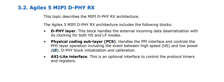

May I Use MIPI Strandard IO (HS/LP Compatible IO) Without Using Altera MIPI-DPHY IP
Hi :
From the Altera agilex 5 MIPI D-Phy IP User Guide,
We Know that We can use MIPI Standard IO (HS/LP Compatable IO) By Using Altera MIPI
DPhy IP.
I Want to ask If we can use MIPI Standard IO (HS/LP Compatable IO) Without Using
Altera MIPI DPhy IP ( Maybe we can Tie the HS/LP Control Signals to the MIPI Standard IO)
If We can not do this kind of things,
May I ask the reason Why we can not use MIPI Standard IO (HS/LP Compatable IO) Without
Using Altera MIPI DPhy IP.
If We Use Altera MIPI DPhy IP, the Data/Clk Lane IO Pin Locations is dedicated by your user
Guide, So agilex 5 FPGA Do actually have MIPI Standard IO (HS/LP Compatable IO),
is the answer Correct !?.....
If agilex 5 FPGA Do actually have MIPI Standard IO (HS/LP Compatable IO), Why we can
not use this kind of IO and Tie the HS/LP Control Signals to the MIPI Standard IO, directly !?...
thanks for your answer.

      From your answer,
      It seems that the agilex5 FPGA MIPI IO can not use alone (must use with Agilex5 MIPI D_Phy)
      because "There is a block who handles the external incoming data deserialization
      with its clocking for both HS and LP modes"
      Is my understanding about this answer correct !?...
      thank you~

    So agilex 5 FPGA Do actually have MIPI Standard IO (HS/LP Compatable IO), is the answer Correct !?.....
    >> following user guide under https://cdrdv2-public.intel.com/834802/ug-817561-834802.pdf
    >> There is a block who handles the external incoming data deserialization with its clocking for both HS and LP modes
    Wincent
