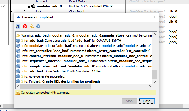

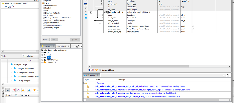

    you can just take what i sent previously, and change the target device to the DA variant rather than DD. after doing so, and opening Platform Designer, you don't see the error in the window:
    you can generate HDL successfully (ignore the warning since this is a dummy design and not fully hooked up to anything useful):

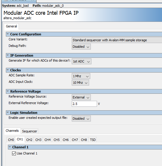

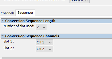

    as for the parameters of the ADC core, it seems to be rather inconsequential. I've tried it with single channels, all channels, etc. and it didn't matter. the dummy design i previously sent has two of them enabled, as well as the sequencer. you can open the block to check it out for yourself.

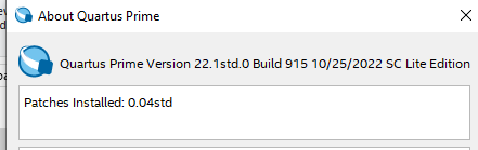

    I successfully installed the patch provided, into my 'lite' version of 22.1:
    i have been able to change my design back to the "DD" variant in Quartus, and then in Platform Designer it does not complain about the ADC blocks. I was able to generate the IP from the Platform Designer, and then successfully place-and-route back in Quartus.
