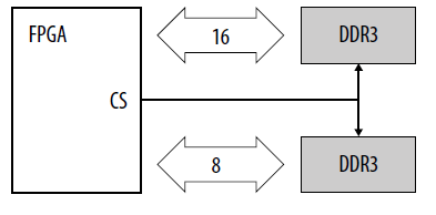

Hello, I am working on my first implementation of DDR3 memory with MAX10 FPGA. My initial direction was to follow MAX10 FPGA Development Kit with 10M50DAF484C8G on board. The main difference is - I ...

Yes you can.
The ECC bit is only set to 8-bit. So you cannot use 4-bit as ECC.

Do I understand it correctly that it is not possible to use MAX 10 FPGA with single 16 bit DDR memory and If i want to use DDR3 I need to have second 8-bit part, even if my design requires 16 bits only?
- Yes, you need to create external memory interfaces to 16-bit SDRAM components with 8-bits error correction coding (ECC).
