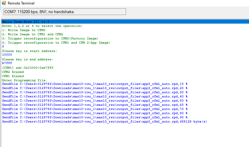

MAX10 RSU upgrade stuck at 100% uploading status
When i try to send upgrade file through serial terminal uploading process stuck at 100% status & then doesn't do anything.
Any idea why this happening ?
  • Hello,
    Thanks for reply.
    I made it work.
    Initially i was using compiled files from provided in Example folder, with that i was getting this issue.
    But after compiling(NIOS program) my self in my system then it worked.
    Thanks for checking.
  • SAB4887's avatar
    SAB4887
    Thanks for reply.
    I made it work.
