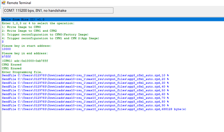

When i try to send upgrade file through serial terminal uploading process stuck at 100% status & then doesn't do anything.

Thanks for reply.
I made it work.
Initially i was using compiled files from provided in Example folder, with that i was getting this issue.
But after compiling(NIOS program) my self in my system then it worked.
Thanks for checking.
