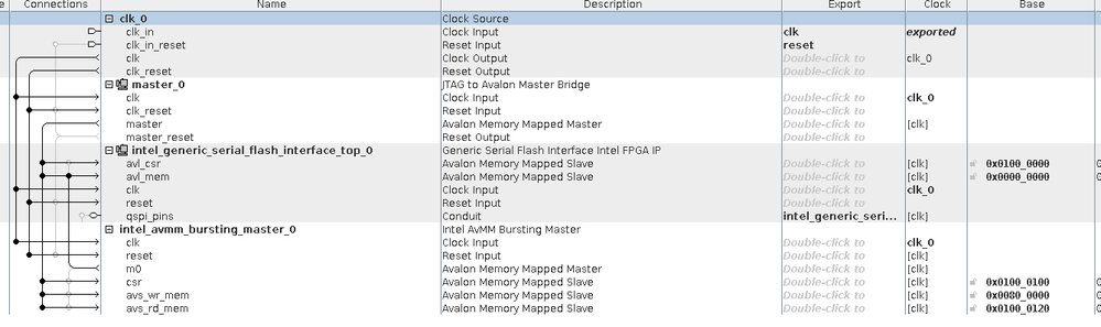

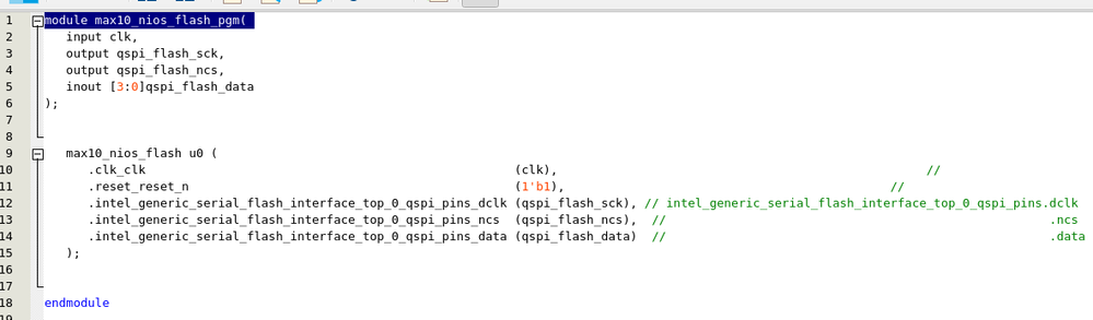

I was able to verify the clock and the jtag loop using the system console. So I can now at least communicate with my system through the system console. Here is my qsys, HDL, and pinout for reference.
The only purpose of this build is to program the external flash chip(from Winbond).

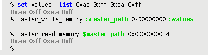

So, now I am trying to write and read from the external flash memory just a list of byte values using the commands listed in the user guide. My code:
set master_path [lindex [get_service_paths master] 0]
open_service master $master_path
set values [list 0xaa 0xff 0xaa 0xff]
master_write_memory $master_path 0x00000000 $values
master_read_memory $master_path 0x00000000 4
I also tried using the addressing from the bursting master in Qsys:
master_write_memory $master_path 0x00800000 $values
master_read_memory $master_path 0x01000120 4
Results:
If I read first, I can read from 0x00000000 and get some bytes back. They are not bytes which I placed there. When I then write to 0x00000000 it seems to go fine, but when i read again it locks up the system and i need to start over.
using the bursting master addressing:
I can write to 0x00800000 and it seems to work fine, but when reading from 0x01000120 I just get 0x00 0x00 0x00 0x00 in return.
So, I am not fully understanding how this read/write operation should work. It seems like it should be pretty simple but it just isn't working for me.
