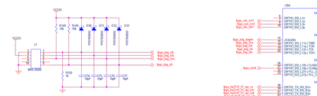

Could you review if my jtag pin and config pin ? using pull up or pull down, pick solution is right? clock using VCCIO, is right?

Yes, your connection for JTAG pins are correct.

1 year agoYou may refer to guide from Pin Connection Guideline : https://cdrdv2-public.intel.com/669875/pcg-01018-683232-669875.pdf
