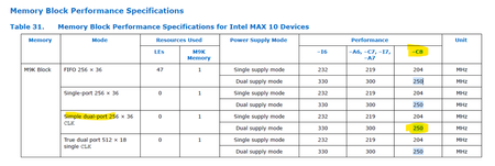

I try to use EPE on MAX10. I generate accuTrack_early_pwr.csv file.
My design have some dual port block ram running at 320MHz:
BLOCK,M9K,count,1,ram_mode,"Simple Dual Port",ram_read_during_...

4 years agoExactly which MAX10 device, speed grade, and temp grade do you have specified in your design?
Because per that table, only the -I6 (fastest) class dual supply device can run the block ram at 320MHz.
You have the -C8 (slowest) highlighted. Is that what you are using?

I use 10M50DAF484C8G, so C8 grade...so slowest.
But my questions are more, why it there a limitation of 260MHz in EPE rather than 250Mhz?
Why also is there nothing appearing 'in red' as an error if Fmax is violated like setup/hold violations (using 320MHz rather than 250MHz)?Thanks for your help.
