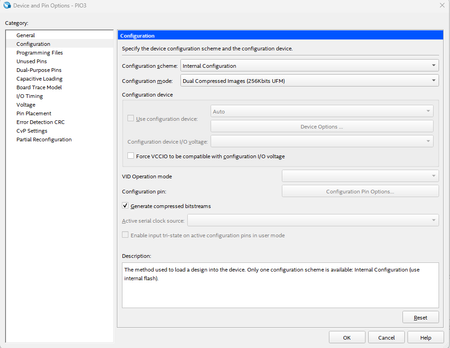

4 months agoMAX10 Dual Configuration
I am using the MAX10 Dual Configuration. The device settings in the Quartus are shown in the image below. The settings for the generation of the .pof file and the .rpd files are shown below:...

Hi CHatz,
A couple of items commonly cause this behavior:
- CONFIG_SEL is only sampled at power up or when you force reconfiguration (power cycle, or pulse nCONFIG). If you change the jumper while running, the device will keep loading the previous image. Check : Try Dual Configuration with MAX® 10 FPGAs
- In Convert Programming Files > Option/Boot Info, please confirm “Configure device from CFM0 only” is unchecked. If it is enabled, the device will ignore the physical CONFIG_SEL pin. Check: Generating .pof using Convert Programming Files
- If you are programming with RPD, make sure you are using the per-partition RPDs (CFM0 vs CFM1) and not a combined file, otherwise it can look like one image overwrites the other.

FvM
4 months agoHi,
not quite clear how you are trying to program the configuration.
Dual configuration .pof file is usually generated with CPF tool combining .sof data of factory and application image.
When loaded into Quartus programmer, flash partitions are shown separately and can be individually programmed.
