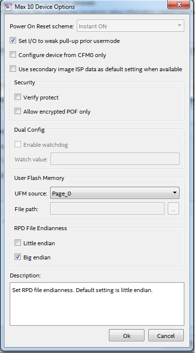

My version is 16.0. If I set Little endian - I see the difference while comparing register values - burned with a pof and burned with a rpd.
- EEren
Yes. I set a Big endian option as I was told. Otherwise I have to reverse every byte before writing it to flash.

can I know when you create the rpd files did you follow as per the max 10 configuration guide steps given in below link page : 39/66
https://www.intel.com/content/dam/www/programmable/us/en/pdfs/literature/hb/max-10/ug_m10_config.pdf
Is endianess set correct ?
