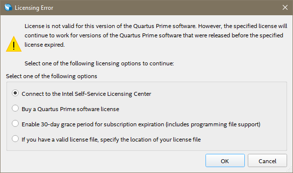

License is not valid for Quartus (Quartus Prime 22.1std) Standard Edition
I installed the Quartus (Quartus Prime 22.1std) Standard Edition and got this error message when I ran the tool.
and this error message when I tried to build the project

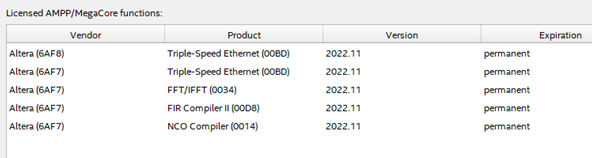

I am having this license
This license worked with v18.1std

    Welcome to INTEL forum. To narrow down this issue, can you please provide me the latest of the following?
    1) license.dat file
    2) assembler report .asm.rpt file
    3) Machine OS information
    You can also reply/attach your file in private message.

      Hello
      We are using nwk license. The license seems to be only applicable for the older version of Quartus, so I downgraded to v18.1 and it is working.
