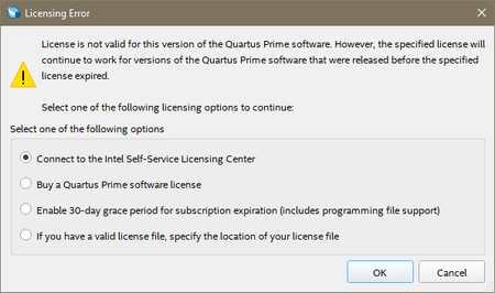

3 years agoLicense is not valid for Quartus (Quartus Prime 22.1std) Standard Edition
Hello, I installed the Quartus (Quartus Prime 22.1std) Standard Edition and got this error message when I ran the tool. and this error message when I tried to build the project I am ha...

- FPGA_Noob3 years ago
Hello
We are using nwk license. The license seems to be only applicable for the older version of Quartus, so I downgraded to v18.1 and it is working.
