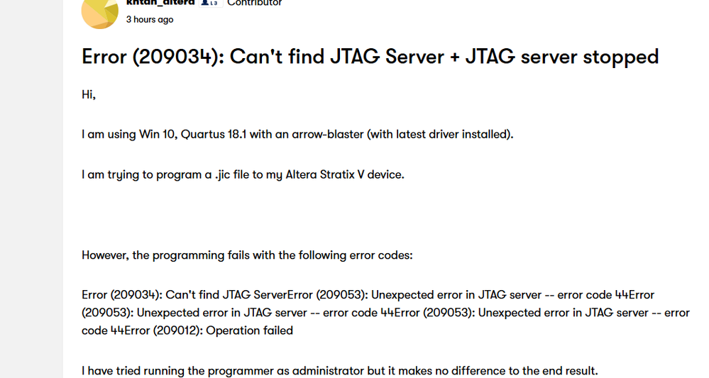

Noted with thanks on the follow-up regarding the JTAG server errors (209034 and 209053).
The combination of these two errors points to a JTAG server issue. Here is how to address each:
- Error 209034 — JTAG Server not running: Open a Command Prompt as Administrator and run
\quartus\bin64\jtagserver.exe --start. To avoid this in future, enable the "Install JTAG Server as a Windows service and run automatically when Windows starts" option. Refer to Installing and Configuring jtagserver on Windows for full details. - Error 209053 / error code 44: Run
jtagserver -vto confirm the version in use. If it is not v18.1 Standard Edition, switch to it — a newer version from a second Quartus installation may be overriding it. To force the correct version, navigate to\quartus\bin64or\qprogrammer\bin64and runqreg.exe --force --setqdir --jtag []. See Error (209053): Unexpected error in JTAG server --error code 44 for more information. - Arrow USB Blaster driver conflict: Open Device Manager and check for any warning symbols on the Arrow USB Blaster entry. Try unplugging other USB peripherals to rule out a conflict. See Why is my USB Blaster II not detected by Quartus II on Windows? for guidance.
Please let us know if you need any further assistance.
