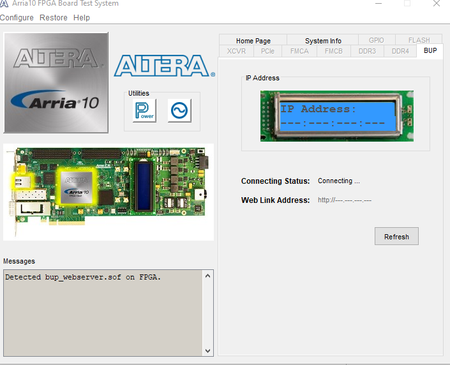

3 years agoIntel Arria10 GX Development Kit - Board Update Portal Web Page
We recently purchased an Intel Arria 10 GX Development Kit (DK-DEV-10AX115S-A).
The user guide of the dev kit says that the kit ships with the board update portal example stored in the fa...

Hi Nazrul Naim,
Thanks for your response. Since I didnt get a reply for a long time I thought this issue was not handled.
We found a solution for this. Rechecked factory setting, and connected the board and host PC to a network switch. It solved the issue.
