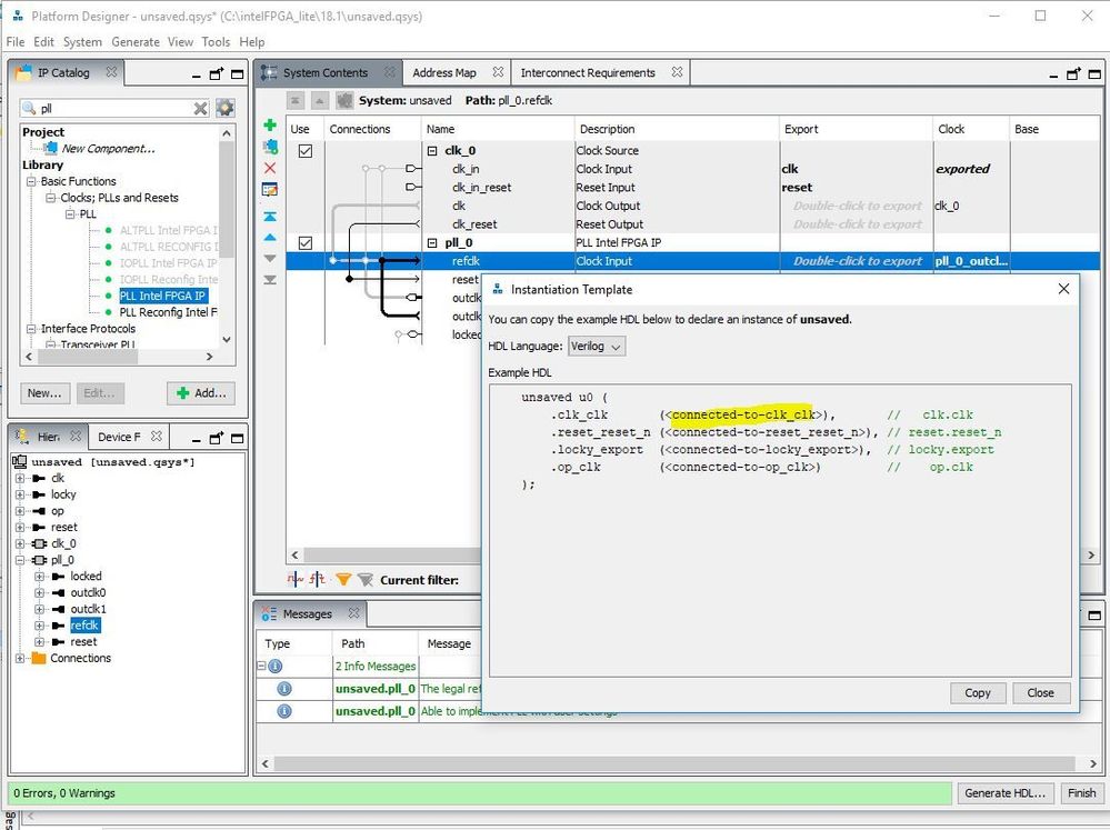

how to instantiate the Altera v17.0 pll in the verilog file.can i get the instantiation code.
  • Vicky1's avatar
    Vicky1
    Correct, Please check the 'Generate' Menu of Platform Designer-> 'Show Instantiate Template' as shown below & provide the 'Top level design signals/wires for instantiation inside braces as highlighted, Template my vary depends on PLL configuration.
    For IP Catalog,
    Vicky

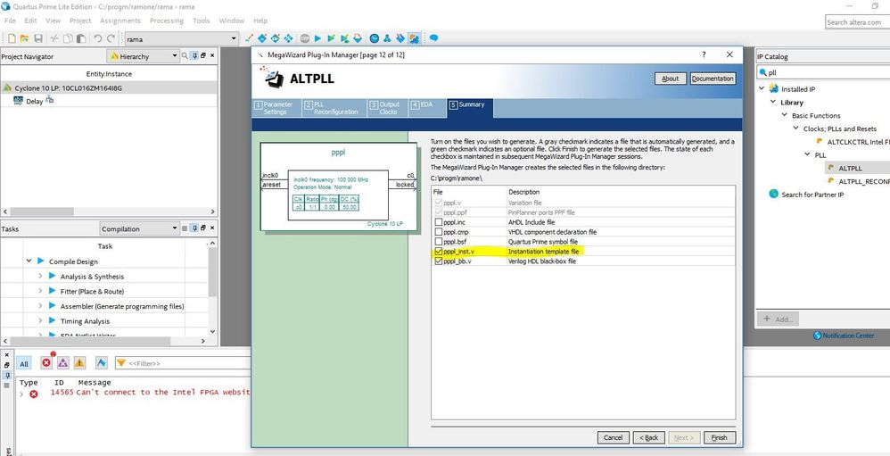

  • ak6dn's avatar
    ak6dn
    Do you use the Tools / IP_Catalog MegaWizard to generate the PLL configuration in the QuartusII tool?
    If not, you should.
    It can generate a template Verilog instantiation file for you.
