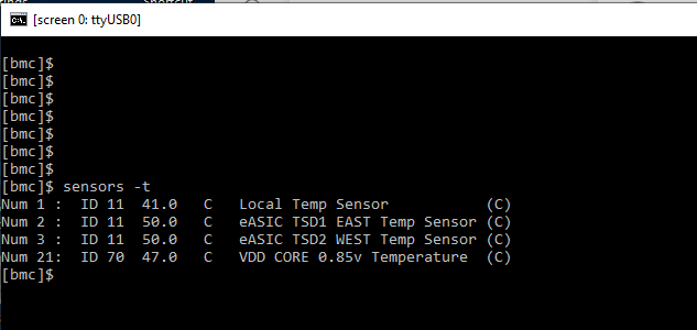

    hi @Rithea
    The BMC USB connector is connected to the PC serial port using a USB-to-RS232 adapter cable. So a serial console is open, then with the serial command "sensors -t" the temperature can be read:

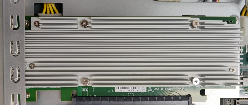

    Which ACC100 card are you using? Can you snap a photo on the label of the card and attach it?
