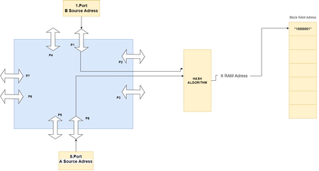

how to fix collision reset problem in ethernet mac table

Seems like your initial description didn't mention whether you are using any MAC IP inside the FPGA IP.
Please let me know if you have use any MAC IP of FPGA.
If you are inquiring about the Triple-Speed Etherent MAC multicast hash table, please consider referring to Table 37 (page 85) of TSE user guide.
https://www.intel.com/content/www/us/en/docs/programmable/683402/22-1-20-0-0/about-this-ip.html
The description of Multicast Hash Table in the user guide:
"64-entry write-only hash table to resolve multicast addresses. Only bit 0 in
each entry is significant. When you write a 1 to a dword offset in the hash
table, the MAC accepts all multicast MAC addresses that hash to the value of
the address (bits 5:0). Otherwise, the MAC rejects the multicast address. This
table is cleared during reset."
Instructions on how to update the multicast hash table are given below:
