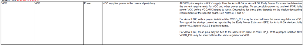

      In the arria II GX device, I use a 0.9V power supply to power the VCC, but the maximum current supported by the power supply is only 300mA. I want to know whether this current can satisfy the chip's work? If not, how much current does the power supply need to output to meet the working requirements.
