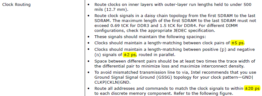

How can I convert "ps" to "mil" in EMIF layout guidelines?
Some design guidelines in EMIF user guide use "ps" as unit, as you can see in the following screenshot.
But in the pcb design, I must check the route lines by mils or millimeter, how can I convert "ps" in the EMIF layout guidelines to "mil"?

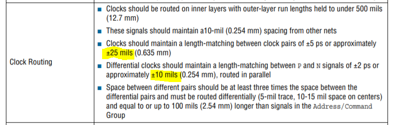

    Good news for you! I found the older version of the EMIF handbook which apply the board guideline in mils. Refer to this link -->

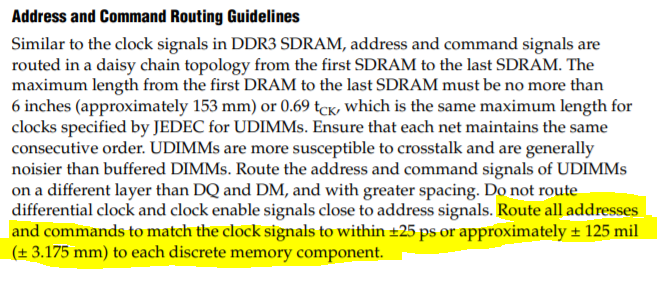

    Routing for address and command routing, Intel recommendations is approximately ± 125 mil (± 3.175 mm) or within ±25ps to each discrete memory component. You may refer to “Layout Considerations For DIMMs and Leveled Components” on page 79 for more information about layout guidelines in above shared link. I also attached below screenshots on both clock , add/cmd routing to ease your viewing.
    I summarize the formula ( based on our document) . This is similar as per shared by @ak6dn​ but I converted it based on our documentation.
    125mil = 0.125inch
    25ps/0.125inch = 200ps/inch
    In short, you can use "200ps/inch" to calculate the delay/length based on your board.
