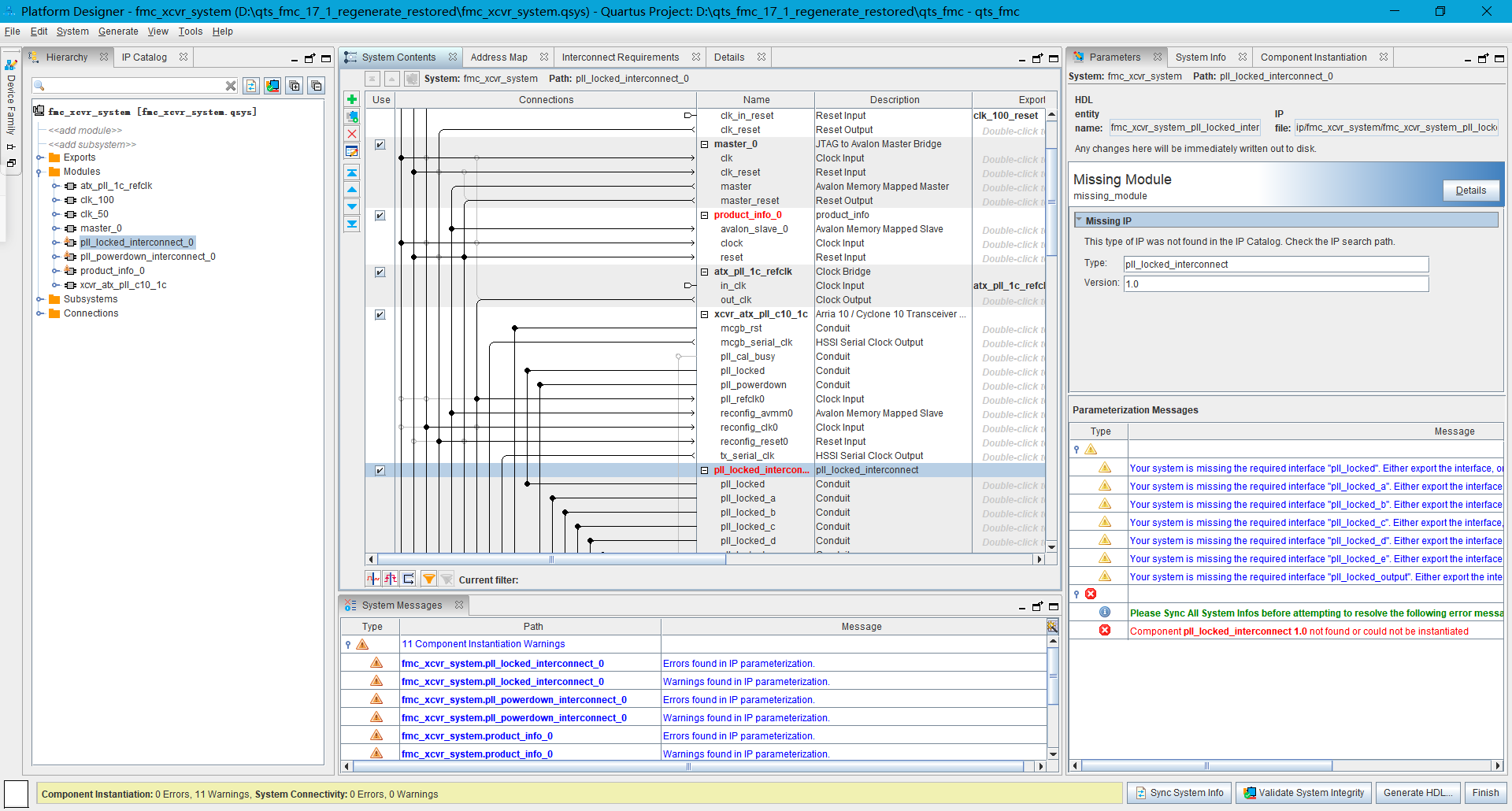

But this time I'm struggling with other problem--I find there are some "missing modules" in both projects ,do you know why and how to solve this?I have post some of the missing modules in missing.png,you can check.

      I didn't make any change with qts_pcie_sfp_17_1_compile_ok.qar project,in Quartus Pro 17.0.
      That two demo could compile successfully, but when I what to check the details of it's ip parameter, I find there are some missing modules.It's so puzzling.

      Hi @LTN
      Are these missing module/components created using the Component Editor in Platform Designer?
      If so, make sure that _hw.tcl files have been created for each one and that they are visible to the tool, typically in an ip directory in the same location as the .qsys file, but you may have moved them.
      If you've moved the files, point Platform Designer to their location with Tools menu -> Options in Platform Designer.

        Hi @RichardTanSY_Altera ,
        Thanks for your reply.
        I didn't move any file of this project.The whole project was downloaded from Intel so I don't know if these missing module/components created using the Component Editor in Platform Designer, how can I check?
