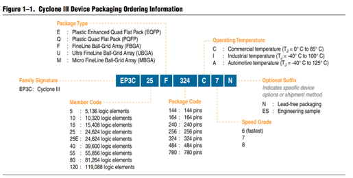

Hi Ramanan,
Please refer the below screen shot from https://www.intel.com/content/dam/www/programmable/us/en/pdfs/literature/hb/cyc3/cyclone3_handbook.pdf?wapkw=cyclone%20III#page=24
C - Commercial Temperature grade
I - Industrial Temperature grade
6 - Fastest speed grade of the FPGA
7 - Slower than 6
8 - Slowest
Speed grade means that the FPGA with 6 can work at faster clock frequencies than 7 and 8.
