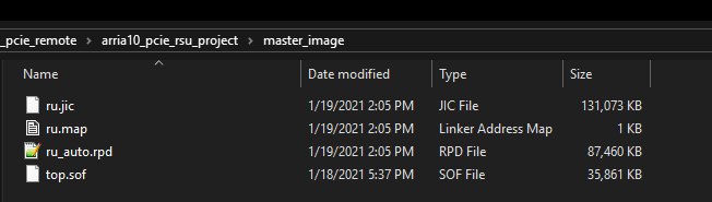

I am trying to emulate the Design Example: Intel Arria 10 FPGA Remote System Update via PCI Express*. i am facing issue when we trying to download any application
can anyone help me on this?
Steps Followed by me
Step. 1 : Load Mater_Image jic file through onboard blaster - Success
Step 2: Reboot the dvk - Success - Four LED glows
Step 3: Copy driver, Install & run the driver - Success
Step 4: download application - Facing issue(PFA)
