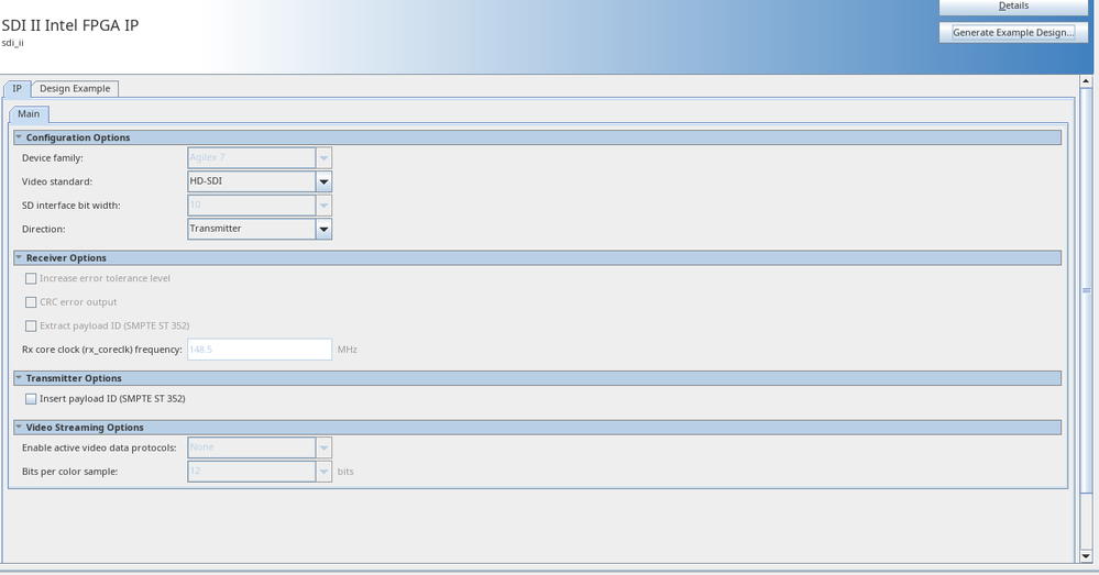

7.2.1. Modifying the Design to Enable F-Tile Transceiver Debug
Attached you'll find a snapshot of what I'm trying to do and I'm getting the error about the user directory failing to create.

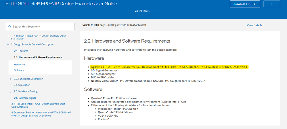

First things. to clarified, If I check back your initial message and your device OPN.- You are using "AGF" F-series device, FYI our F-tile SDI II design example is only supported "AGI series" of device
- https://www.intel.com/content/www/us/en/docs/programmable/710496/24-2-19-5-0/hardware-and-software-requirements.htmlif you need it to be fully supported, some customization of custom code might be needed
