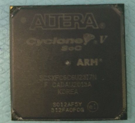

- Problem description: FPGA U1 (ALC3-1AB425040001) load failed
- Detected by: Customer field failure, failure confirmed by factory tests
- Quantity Affected: 1 PCS
- Failure Message: “Card failure-communication”

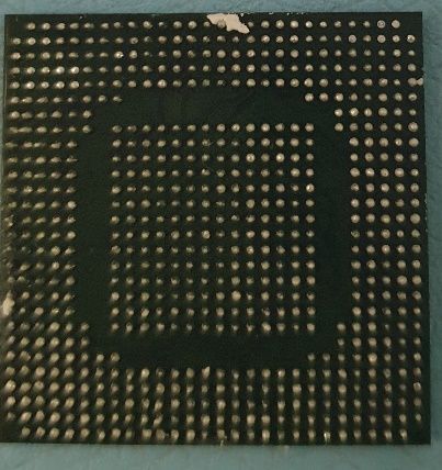

- Flex or Nokia analysis:MISSING PINS
This card failed at customer with no boot issue.
The nUBCM card failed at Prescreening test with “Card failure-communication” error. The failure is caused by FPGA U1 load failure and keeps repeating the load failure message continuously.
Replacing the component solved the problem and card passed factory tests.
