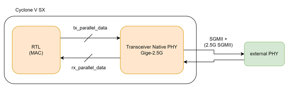

      So, can I implement a simple Ethernet frame processing (MAC Layer) in RTL, then connect the RTL to the Native PHY, and use an external PHY component like SGMII+ (e.g., GPY211) to achieve 2.5G Ethernet? Is this feasible?
      Thank you very much.

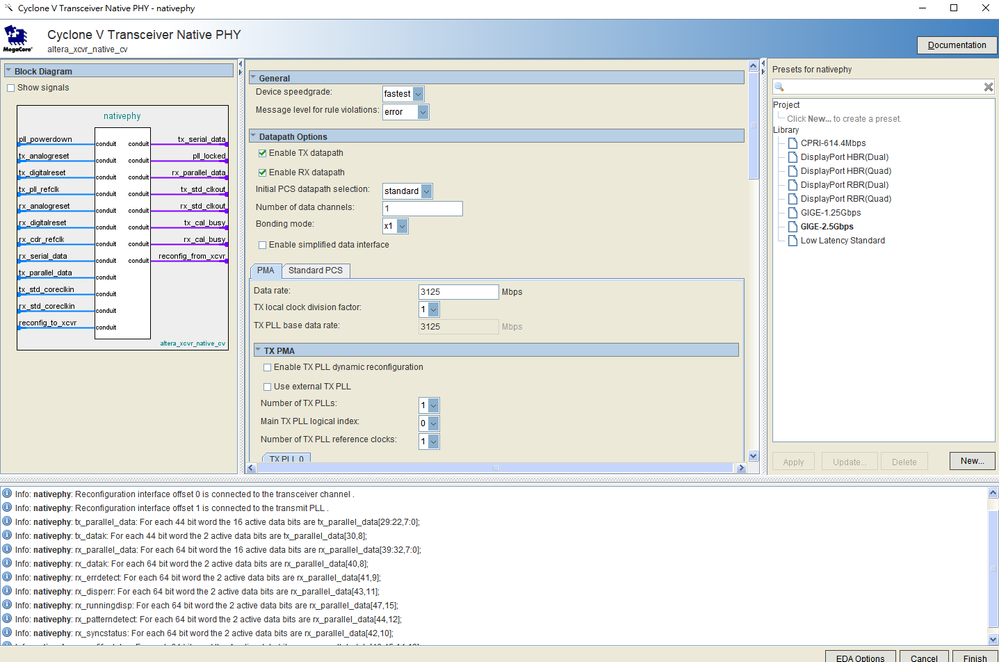

      I instantiated a Native PHY IP within the Cyclone V SX and used the IP Library to set GIGE-2.5Gbps. I can see that the IP sets the Data rate to 3125Mbps on the PMA configuration page (as shown in the image). Doesn't this indicate that the Cyclone V SX is capable of 2.5Gbps Ethernet?
  • Jeet14's avatar
    Jeet14
    Unfortunately, we don't have support for 2.5G ethernet support from the HPS or FPGA side on Cyclone V SX device.
    On Cyclone V SX SoC FPGA, at HPS side you can use ethernet only 10/100/1000 Mbps.
    https://www.intel.com/content/www/us/en/docs/programmable/683126/21-2/ethernet-media-access-controller.html
    But in Cyclone 10 GX device, you can use the 2.5G ethernet.
    https://www.intel.com/content/www/us/en/docs/programmable/683054/20-1/about-the-1g-2-5g-5g-10g-multi-rate.html
    Tiwari

      Hi Jeet14,
      thank you for your reply,
      I saw in the documentation that both the Cyclone V Transceiver Native PHY IP Core and the Custom PHY IP Core support GIGE-2.5Gbps PCS. Can't these be used to implement 2.5Gbps Ethernet?
