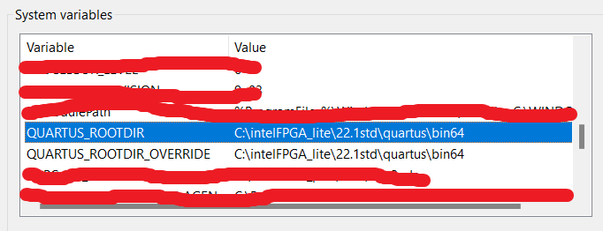

    Can you try to add the variables in System variables?
    You can add QUARTUS_ROOTDIR_OVERRIDE too in this case.

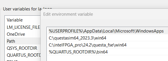

    Hi Azmin,
    Per your advice, I added to the "%QUARTUS_ROOTDIR%\bin64" to my PATH variable and restart the computer but still not solving the problem.

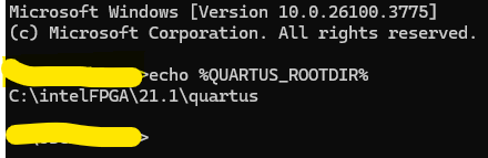

    Why it always point to older Quartus version which no longer in my computer?

    This is how I setup the variable (added the bin64) but it doesn't works.
    In the command prompt, it still pointing to the old Quartus version which has been already uninstalled. Now I only have one quartus installed in my PC.
    Is my variable setup incorrect? Can you attach the correct setup for my reference?

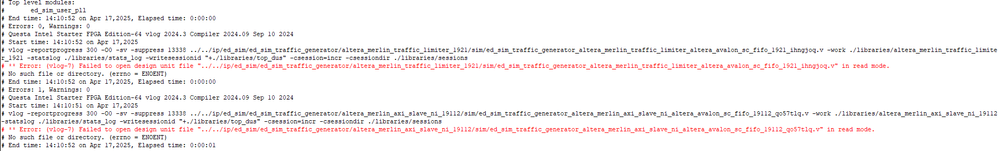

    I regenerate the ED and no longer seen the error. But now running into another issue whereby the questasim will auto closed by itself.
    I checked the transcript and this is the last line being captured
    # Running constra
    # SIMSF (ed_sim.emif_io96b_lpddr4_0.emif_io96b_lpddr4_inst.arch_emif_0.arch0_1ch_per_io.arch_0.gen_byte_conns[0].wrapper_byte.gen_used_byte.u_byte): Could not find Quartus installation - missing environment variable QUARTUS_ROOTDIR
