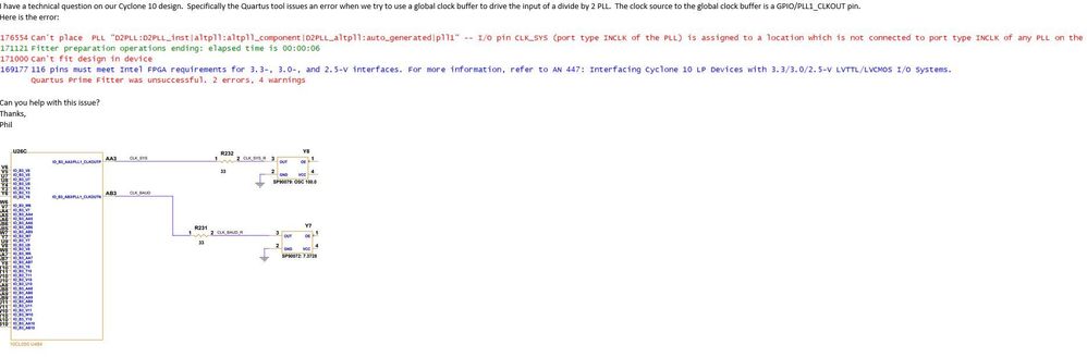

one of my clients is having problems when he tries to use a global clock, I attach an image with the error.
Could you please help me?

      The board has been laid out and the 100MHz FPGA system clock (CLK_SYS) is unfortunately connected to pin AA3, so we cannot change the location for the I/O pin at this point in time.
      Could you recommend some other workaround?
  • CAUSE: You assigned a pin to a location that is not connected to the specified port type of the specified fast PLL or enhanced PLL . As a result, the Fitter cannot place the PLL.
    ACTION: Change the location assignment for the I/O pin or delete the assignment.
