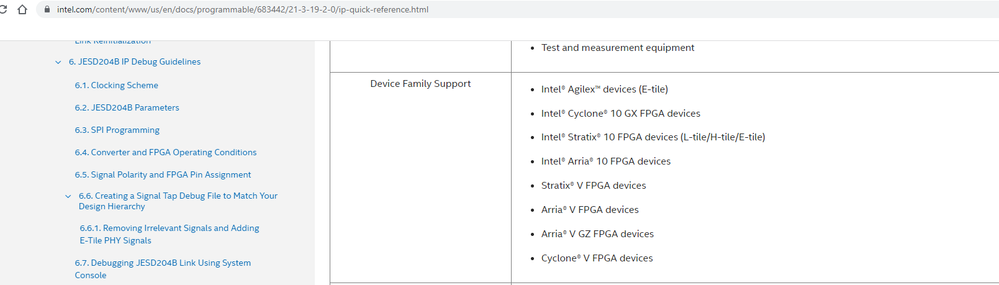

Thanks for your response. From the second link you have given, it mentions that JESD204B IP is supported by Agilex devices (E-tiles). Attaching image below.
Where can I find if my F-series device has E-tile?. For instance, I am seeing different tiles : R-tile, F-tile, P-tile, H-tile, and E-tile. Is there any document which explains which tiles does F-series devices has?

Hi Sir
Yes, Agilex F-series FPGAs can support JESD204B IP.
Below are the related user guides.
1) Intel® Agilex™ FPGA IP Design Example User Guide
2) JESD204B Intel® FPGA IP User Guide
URL: https://www.intel.com/content/www/us/en/docs/programmable/683442/21-3-19-2-0/ip-quick-reference.html
