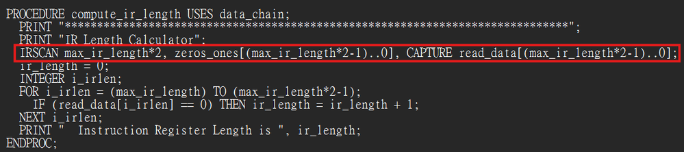

Figure 1: The crash location of idconde.jam
I am step-by-step tracing the source code of JAM STAPL PLAYER, focusing on the `main()` function in `jamstub.c`. From `main()`, the execution flow proceeds as follows:
1. `jam_execute()` (in `jamstub.c`)
2. `jam_execute()` (in `jamexec.c`)
3. `jam_execute_statement()`
4. `jam_process_irscan()`
5. `jam_process_irscan_capture()`
6. `jam_swap_ir()`
7. `jam_free()` (in `jamjtag.c`)
8. Finally, it reaches `free()`.

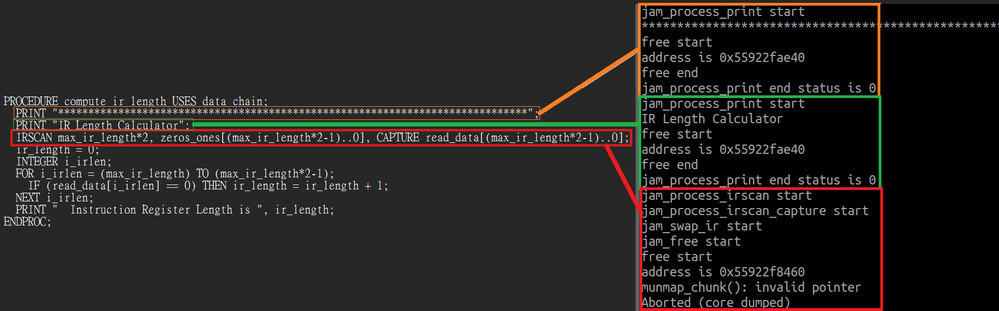

To track the program’s execution, I added log messages indicating `func start` and `func end`, along with the current status (`status is x`), in the following functions:
- `jam_process_print()`
- `jam_process_irscan()`
- `jam_swap_ir()`
- `jam_free()`
- `free()`
Through these log outputs, I found that the crash occurs at the `free()` function. At this point, I suspect the issue is related to memory deallocation, potentially caused by an invalid pointer or memory alignment problem.
Figure 2: Trace Code Sequence
