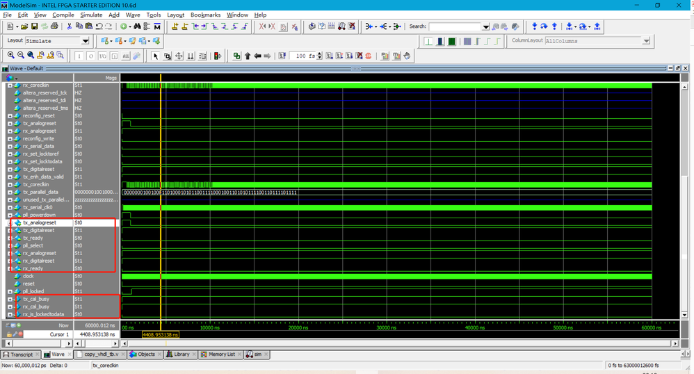

I have downloaded Quartus Pro 19.1 and compared the example with my project.Then i modified its parameter like the example.But i didn't get what i want,only get this:
Do you know what's wrong with my project?

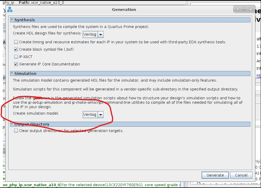

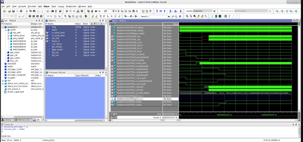

I took the design and generated the simulation models for the IP and I notice that these options were not selected by default. Is it possible that you are trying to simulate the design with the synthesis RTL? You cant do that.
I hacked my simple testbench and simulated your project with it. As you can see it works just fine. I’ve attached the project with my testbench back to you.

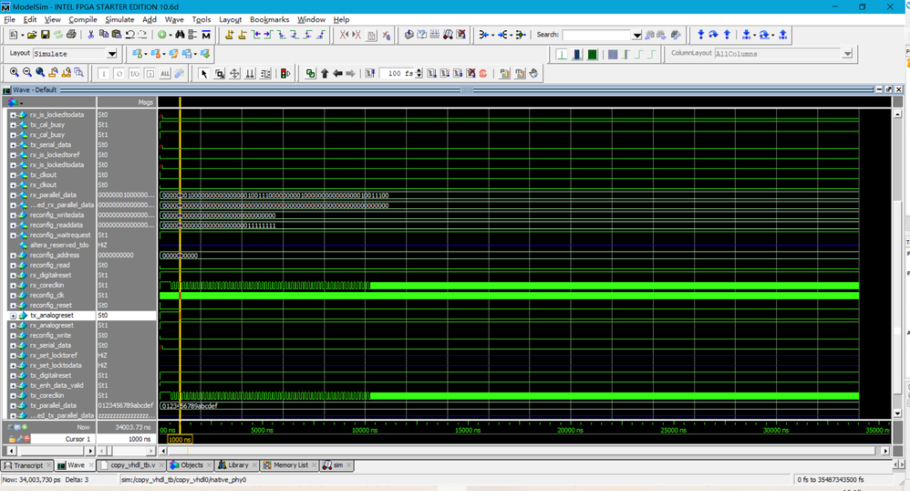

Hi @RichardTanSY_Altera ,
Here it is.
- RichardT_altera4 years ago
Hi @LTN
in the previous reply I stated the following“Simulated one of the designs and saw the same behaviour that you describe. Could you try to enable the dynamic reconfiguration interface on the PHY, and ensure that the reconfig_clk is driven (same CLK as the Reset Controller should be OK), Please also ensure that the reconfig_reset input port gets a power on reset. When I did this it fixed my problem here.”
The screenshots you provided do not show the Avalon Memory Mapped interface dynamic reconfiguration port clock or reset.
