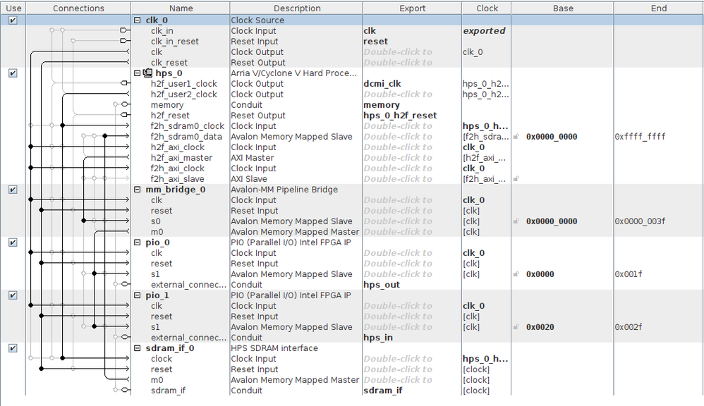

It's wired in the Platform Designer like this:

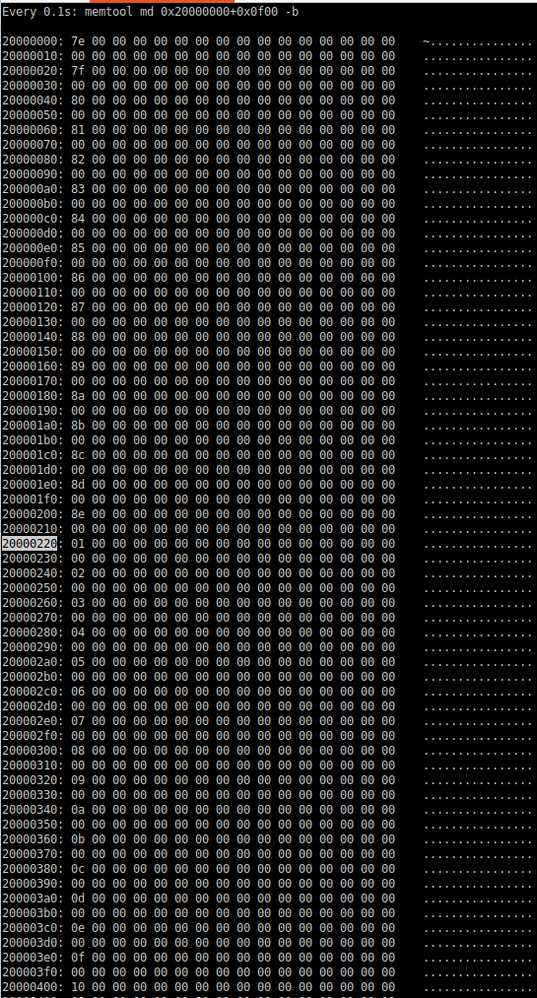

I am checking the SDRAM content from HPS using memtool. The problem is the address keeps incrementing by 16B (256 bits, data width) even when it should remain fixed to 0x2000_0000. Sometimes there is a delay before first write transaction occurs for some reason, also sometimes write transactions stop happening or the address goes back to the start.
Example memory content looks like this (I also highlighted an adress when I released the reset button - the counter did reset but the address did not):
What am I doing wrong? Why the address keeps incrementing and how to fix it?
