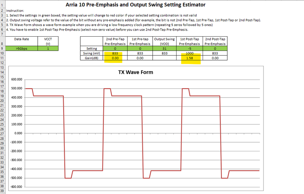

As arria 10 register map excel sheet, shows only for transmitter parameter.
Please share the document/excel sheet for RX analog parameters.

There is no similar sheet for the Rx side. However, you may use tools like Transceiver Toolkit to view the impact of the changes to TX parameters on RX side.
