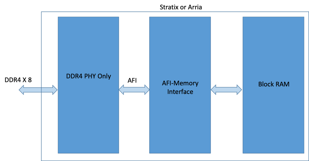

      When DDR4 EMIF IP is configured as hard PHY Only, can it be used be used as a Slave? Do you anticipate any issues with caIibration?
      I like to make a simple prototype as shown below. Do you think this is possible? I don't need that much logic; just the AFI to block ram interface and some block RAM for testing. Which FPGA do you recommend; Stratix, Arria, or something else. I only need 8 lanes of DDR4. For prototype, I can even use DDR3.

    Do you have a better suggestion? Is the FPGA DDR3/4 Phy interface a DFI?

    you don't refer to a specific FPGA family.
    I believe it could be possible to reuse Arria 10 or Stratix 10 DDR4 PHY for the intended purpose, but it means to design a DDR4 device controller from the scratch. At the end you might stumble upon a missing feature of the existing hard IP. Sure you want to take this rocky road?
