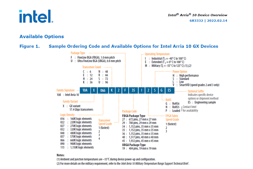

I would like to understand the "optional suffix" mentioned in the Arria 10 Device Overview.
Can you kindly brief on what the optional suffix means here?. What are the device options available?
In one of the OPNs I would like to order, I saw the optional suffix as "JZ" - May I know the meaning of this JZ?

    Thank you for contacting Intel Community.
    Please note that the device part number ended with the additional suffix 'JZ' is referring to customer specific ordering suffix, the material that builds directly for some specific customer request. These are added to the device part number when a device has under gone additional qualification upon request. For general part ordering, you may look for part number without the additional suffix.
