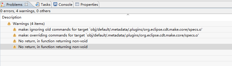

      The code is compiled with no errors and more warnings, as shown below:
      allen regards !
