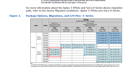

Based upon Agilex device overview the A5E 008B, A5E 013B & A5E 028B are meant to be compatible and "migratable" as shown here However when I tried to choose A5EC008BM16AI4S as my current device...

Hello Eza,
I have verified that the same findings were found in the latest Quartus version.I am checking this with the internal team to confirm. This could be a document discrepancy.
I will update you once got any more findings.
