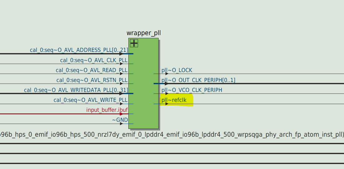

From the generated netlist (see attached images), it appears that the PLL associated with the EMIF in bank 3A receives the external CLK (K105/M105), the PLL reference clock is then internally forwarded/shared to the PLL associated with the EMIF in bank 3B. The design routes and fits successfully.
This is the intended DDR architecture on my board and works correctly.

For debug purposes, I would like to use the LPDDR4 External Memory Interfaces (EMIF) IP together with the EMIF Debug Toolkit. Since this IP only supports up to 1x32 LPDDR4, I instantiated one LPDDR4 EMIF in bank 3A and one LPDDR4 EMIF in bank 3B.
The EMIF in bank 3A works correctly when using the REFCLK in bank 3A (on K105/M105).
However, I cannot get the EMIF in bank 3B to fit when its PLL reference clock is assigned to the same REFCLK source located in bank 3A. The fitter reports routing/connectivity issues.
