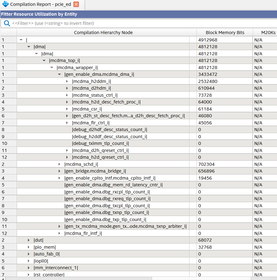

Hello again,
I tried to play with the MCDMA IP, I just generated the example design.
I used "A5EC065BB32AE4S", a small device which matches most closely to what we planned.
But the compilation fails due to insufficient M20Ks!
(Error(170019): Project requires 489 M20K RAM blocks, but the selected device can contain only 229 M20K RAM blocks)It needs almost 5MBit, almost all memory, but the fitter needs much more blocks.
I don't see any memory requirement settings... do you have any hint?? To tweak the buffers/fifos used inside the IP?
I understand that it could cost the performance, but that's acceptable.
For example, I don't need H2D at all... I would keep it at minimum.
Gabriel

- GabrielC11 months ago
Hi Wincent,
You missed the most important part
"the example design", I mean ONLY the example design (PCIe x1), no user logic, only generated boilerplate (gts pcie, gts mcdma, system PLL, reset, and 2 small demo onchipmem).The MCDMA IP uses internally a LOT of memory! (e.g. mcdma used memory factor ~70x compared to pcie)
It just doesn't fit (memory, not logic) into smaller devices like A5EC065BB32AE4SThere are many/big buffers inside the IP (submodules), which need to be adjusted to fit.
See the attached report, "dma" is the MCCDMA and "dut" is the AXI PCIE IP.The IP needs tuning parameters.
e.g. I don't need H2D and even reordering.Regards,
Gabriel
