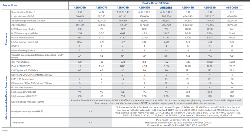

Hi
Does quartus 24.3.1 pro for agilex 5 supports A5E 028B devices?

  • KianHinT_altera's avatar
    KianHinT_altera
    FYI, Quartus Pro 25.1 just launched and you can download it from the website.
    KianHinT_altera
    Checked with our Agilex 5 program manager, A5E 028B will be supported in the upcoming Quartus 2025.1 pro release.
    KianHinT_altera
    Hi Dany,
    Sorry for the delay as was having a number of backlog on my side, I've checked on the Quartus 24.3.1 build 102 and the supported devices list does not have A5E 028B listed down as supported.
    It is listed on the product table though, thus I'm trying to confirm with our factory people on this
    Kian

    • Dany2's avatar
      Dany2
      Hi
      I was wondering regarding this device A5E028B (No HPS, No XCVR) with the package M16
      It looks like it doesn't exist , right now. Can you please confirm? Does Altera planing to have such device?
