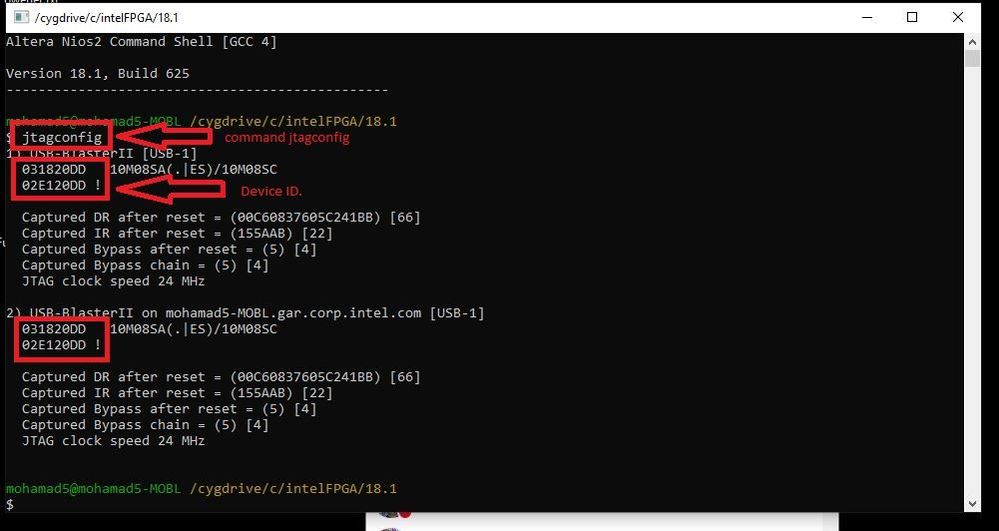

Have you try command "jtagconfig' your new USB Blaste device? and, please show me the screenshot of jtagconfig.
- open Command Prompt ---> go to Quartus directory <Quartus installation directory>intelFPGA\18.1\quartus\bin64> ---> run jtagconfig
