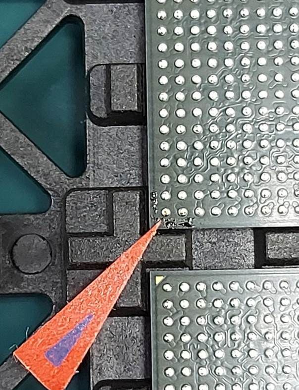

5M1270ZF256C5N *1pcs with solder ball contamination
For Bill of Lading Numbe :3819900755 received this week from Arrowasia,
We found quality issue #106200000106A/ 5M1270ZF256C5N *1pcs with solder ball contamination as below ,and rejected from IQC team.
Please confirm next step, should be arranged 90pcs for replacement? When? Or just debit for this 1pcs ?

  • Hi,
    For your information, Intel PSG perform 100% Scan prior to shipment, so it's unlikely that the device will have been shipped with a contaminate solder ball. There is a high possibility that it was damaged in transit or shipping or improper storage. We have ball scan and visual test. Plus, we have drop test proved packing. The purpose of production testing during manufacturing is to screen out bad units. Intel PSG Reliability Report had stated clearly that Intel PSG performs comprehensive testing and manufacturing controls on all its products.
    We could guarantee devices leave factory door in good condition. Once shipment leaves factory, we are no longer liable as it subjects to forwarder’s handling, distributor’s handling and customer’s handling. There is no way to tell if the damages are done before devices leave factory door. Therefore, no ERMA/RMA will be proceeded due to the solder ball contamination.
    Please contact your distributor (Arrow Asia) in this case as you received the device from them.
    Aiman
    • doris_tu's avatar
      doris_tu
      hi sir,
      we
      We received the reply from arrow asia. This is shipped through Intel directlyand did not go through the warehouse.
      Please confirm the reason for the outflow of this defective 1 pcs, and kindly take the next step for ERMA/RMA , tks!

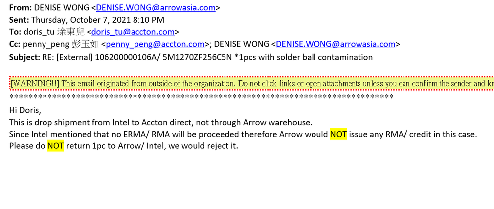

      • doris_tu's avatar
        doris_tu
        please help to check the below message and advise,tks
