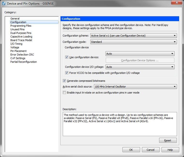

the configuration of Quartus 13.1

Does the second (new) device program successfully? - It should be obvious if it doesn't.
Are you absolutely convinced you're programming the new part with the same configuration file? Sorry this sounds daft but it's happened (several times) on the forum before...
