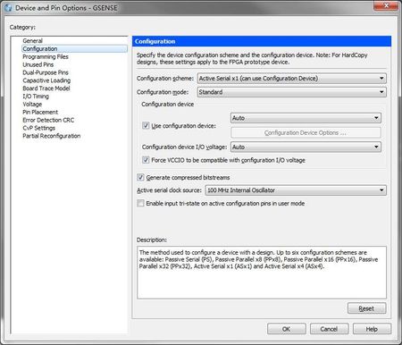

Hello! everyone,I had a problem with Flash recently I used to use Cyclone V (5CEFA7F27I7N) with Quartus 13.1, and the flash I used is MX25L25635EZNI-12G, I add [EPCS-C22019] # EPCQ256N (Eon-lead-fr...

8 years agoDoes the second (new) device program successfully? - It should be obvious if it doesn't.
Are you absolutely convinced you're programming the new part with the same configuration file? Sorry this sounds daft but it's happened (several times) on the forum before...
