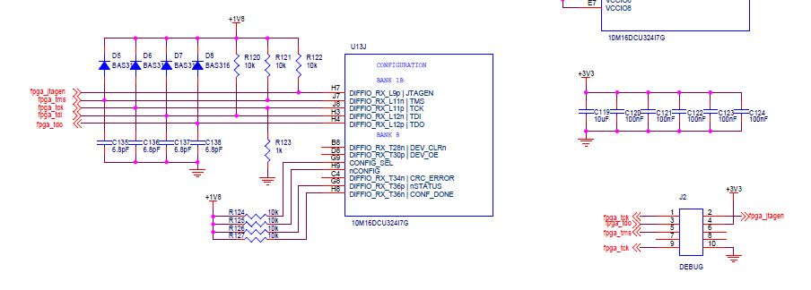

10M16DCU324I7G schematic review
1) How to get schematic support? email works ?
2) Below schematic support USB blast debug? Any issue?

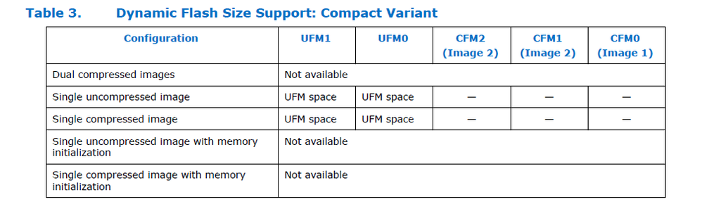

3) Can 10M16DCU324I7G support intel user flash to store user data?
I am not sure the single means in below table? Should not single power supply right?
5 Replies

- NurAiman_M_Intel
Sorry to let you know that we do not support schematic review through our forum. Please contact Intel sales representative based on your region.
Aiman
- NurAiman_M_Intel
To check your connection, kindly refer to device pin connection guidelines
https://www.intel.com/content/dam/www/programmable/us/en/pdfs/literature/dp/max-10/PCG-01018.pdf

- XQSHEN
yes, I have checked intel documents.
To ensure my understanding correct, can I also get support from intel to review my schematic?
- sstrell
I don't know about the schematic, but single and dual in the table refers to whether you have a single programming image or two programming images (main image and backup image or manually switching images during normal operation with remote system update feature).
