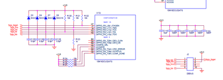

5 years ago10M16DCU324I7G schematic review
1) How to get schematic support? email works ?
2) Below schematic support USB blast debug? Any issue?
3) Can 10M16DCU324I7G support intel user flash to store user data?
I am not sure th...
