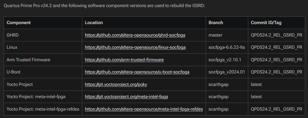

A suggestion to build the source using the steps in the link below:
However take note to use the combination of the software component below for Quartus 24.2:
I have verified the steps are working with the Quartus 24.2 combination.

- tehjingy_Altera
Hi
Do you have any follow up questions on this issue?
Are you able to build the binaries with the suggestion in previous comment?
Jingyang, Teh
